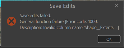

Save edits failed. General function failure [Error code: 1000. Description: Invalid column name 'Shape__Extents'.. ]

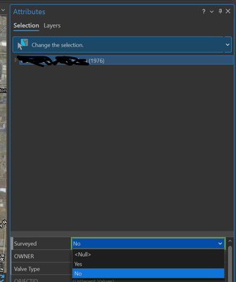

I'm batch editing Hosted Feature Layer attributes in ArcGIS Pro and I receive this Save Edits Error Code. If I select 100-200 maybe more, edit the attributes and click save, I don't receive this error. So to push my edits through, I have to repeat these steps for the rest of the few thousand features to update their attributes.

In the Hosted Feature Layer setting in AGOL, I had "Keep track of changes to the data" Toggled On. I turned it off, repeated my original test and didn't receive the error. This time I selected 2,000 features and attempted to edit the same attribute and it worked.
This looks like a bug, I will have to do some more testing, with this an other layers, we shouldn't have to turn off our change log to do batch editing with a "large selection".
