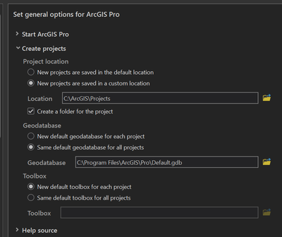

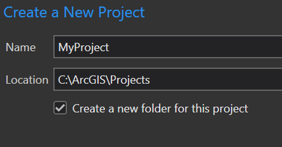

When you create a new project, it's a checkbox:
It's also in the General Application settings:
So just change that to not create folders and default to whatever folder you want your project files to end up in, and that should do it.

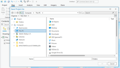

Thanks for the quick answer.  If you start from a Map template, yes I see the option to turn off the folder.
However, the workflow we sometimes have is to start without a template and then save later if the project is something that needs to be saved.  When you follow that path, you do not get the option to not create a folder for the project.
Perhaps this is something I should put in the "Ideas" community to have this same checkbox available when you are saving from an open ArcPro window?

Save project as only gives an option to create a new folder (which I have to delete after, move my .aprx file then relink). Painful !
Strangely enough, sometime I have the folder only option, and sometime I have the Project (APRX) only option
