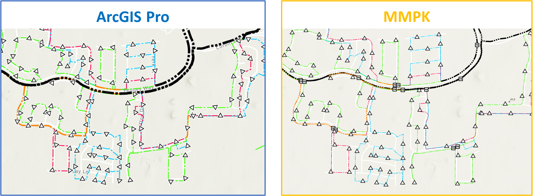

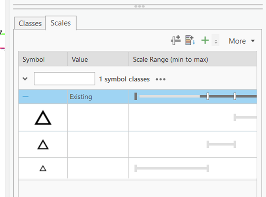

I applied "scale-based symbol classes" on my layers so that the I can use different size of the symbol or alternative symbols at various scale of the map. It looks good on ArcGIS Pro, but when exported into a MMPK file, the layers with "scale-based symbol classes" lost the rotation ( i.e. an Arcade based expression).
I noticed that the layers with no "scale-based symbol classes" the custom rotation displayed correctly on the MMPK file, so it seems that the issue lies with the MMPK not being able to support symbol rotations for "scale-based symbol classes".
