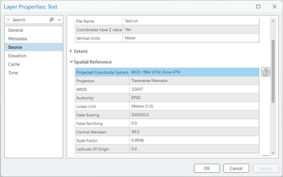

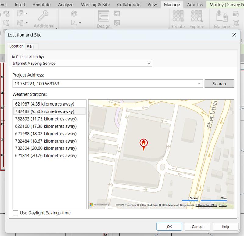

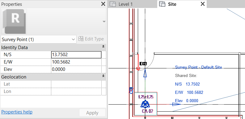

I’ve set both the Project Base Point and the Survey Point, and I’ve also configured the Location and Site settings.

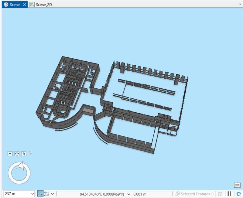

However, when I drag the Revit file into ArcGIS Pro, it ends up in the wrong location with an unknown coordinate system. Even though I’ve already set the coordinates, the location is still incorrect.

Thank you for your reply. I’ve followed the instructions in the video.
However, my Revit file still appears in the wrong location, in the ocean, even though it already has a coordinate system.
