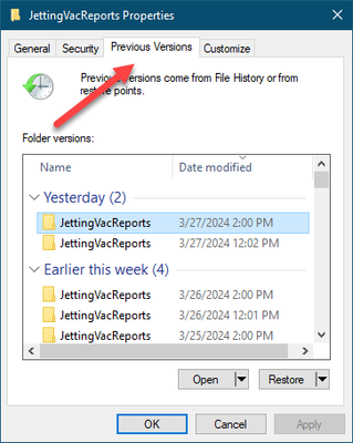

If you are lucky enough to have the shapefiles on a windows folder with system restore enabled, you can get properties on the folder the shapefiles are in, look at the Previous Versions tab and select the files as they were on the respective date/time.
