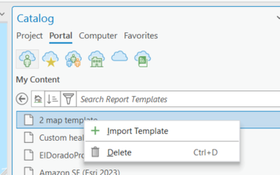

Hello Chrisstian. You can import your report templates (created in the Web App) into ArcGIS BA Pro by performing the following steps:
  1. Navigate to the Catalog pane and click Portal > My Content. This will show all your items in your current portal.
  2. Click Report Templates to see the available custom templates you created in the Web App.
  3. Right-click the template you want to use and click Import Template.
  4. A status bar will appear: Importing report template... When finished, the Import Template dialog box will appear.
  5. Click OK.

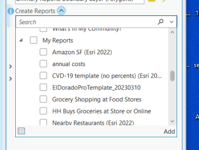

  6. You will now see your report template inside parameters that access the templates—for example, Create Reports in the Summary Reports tool. You will find it under My Reports.

Thanks for this information - when I am right clicking on my BAO reports, however, I am only getting an option to delete the report, not import it. I've checked and these reports haven't been imported yet, so I am at a bit of an impasse. Do you have any suggestions on settings I may've missed? Thanks!

Sorry about the previous post. I did not mean to hit send. To follow up, it is possible that you may have selected a non-template—for example, a Statistical Data Collection and attempted to import it. SDCXs have similar icons but have the only option to Delete.
