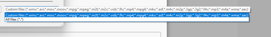

All the standard video files - see image below.

the Powerpoint use when I export is mp4 file.
