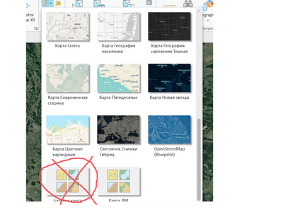

Hi, guys. I accidentally create one extra basemap. How can I remove it and is it possible? Thanks a lot
CaliPearce
I'm wondering the same thing
CaliPearce
I figured it out! Make sure it's not currently on your map, open the catalog view and then you should find it under your projects folder and you can right click delete.
