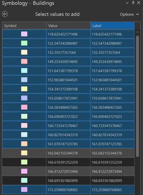

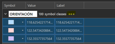

In Pro 3.3.1 select the classes you want to remove. First remove all values it adds by default by click on the three next to 100 symbol classes and click on remove heading and classes
then once they are removed click on the green + sign and select the ones you want to add

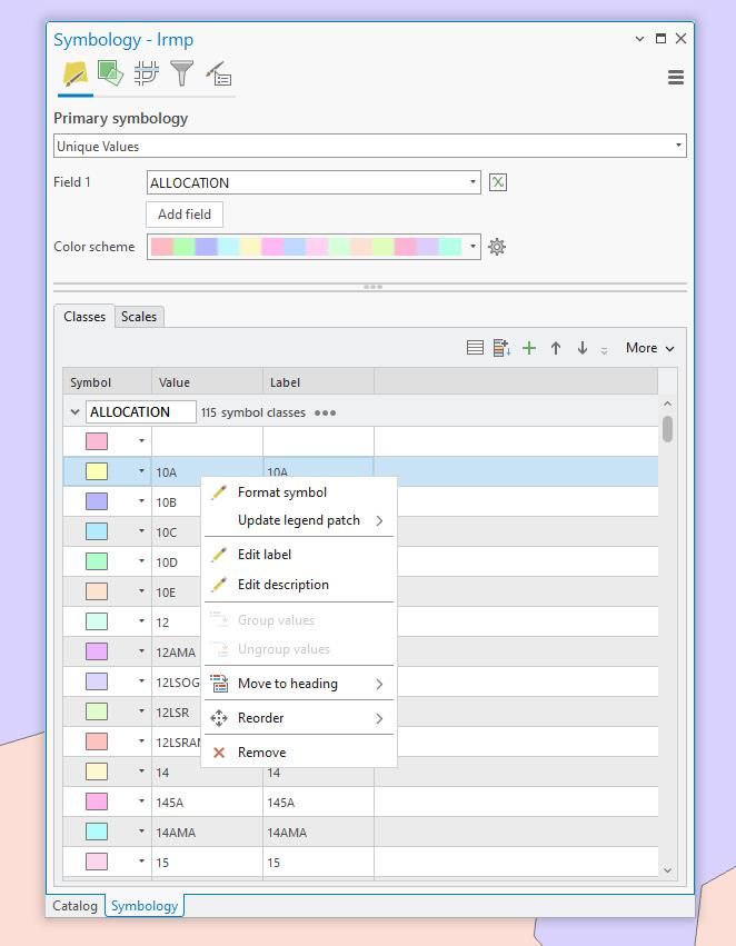

What I do is right click on the value, and then select the remove value option. I do it one by one, so I'm not sure if you can select multiple and remove them in one fell swoop.
Pukawai
That works! But only IF you right-click in just the right spot on the row. Elsewhere you don't get a context menu at all. Thank You. I did try it on multiple selected value rows (n just the right spot) and it did get rid of all the selected ones.
