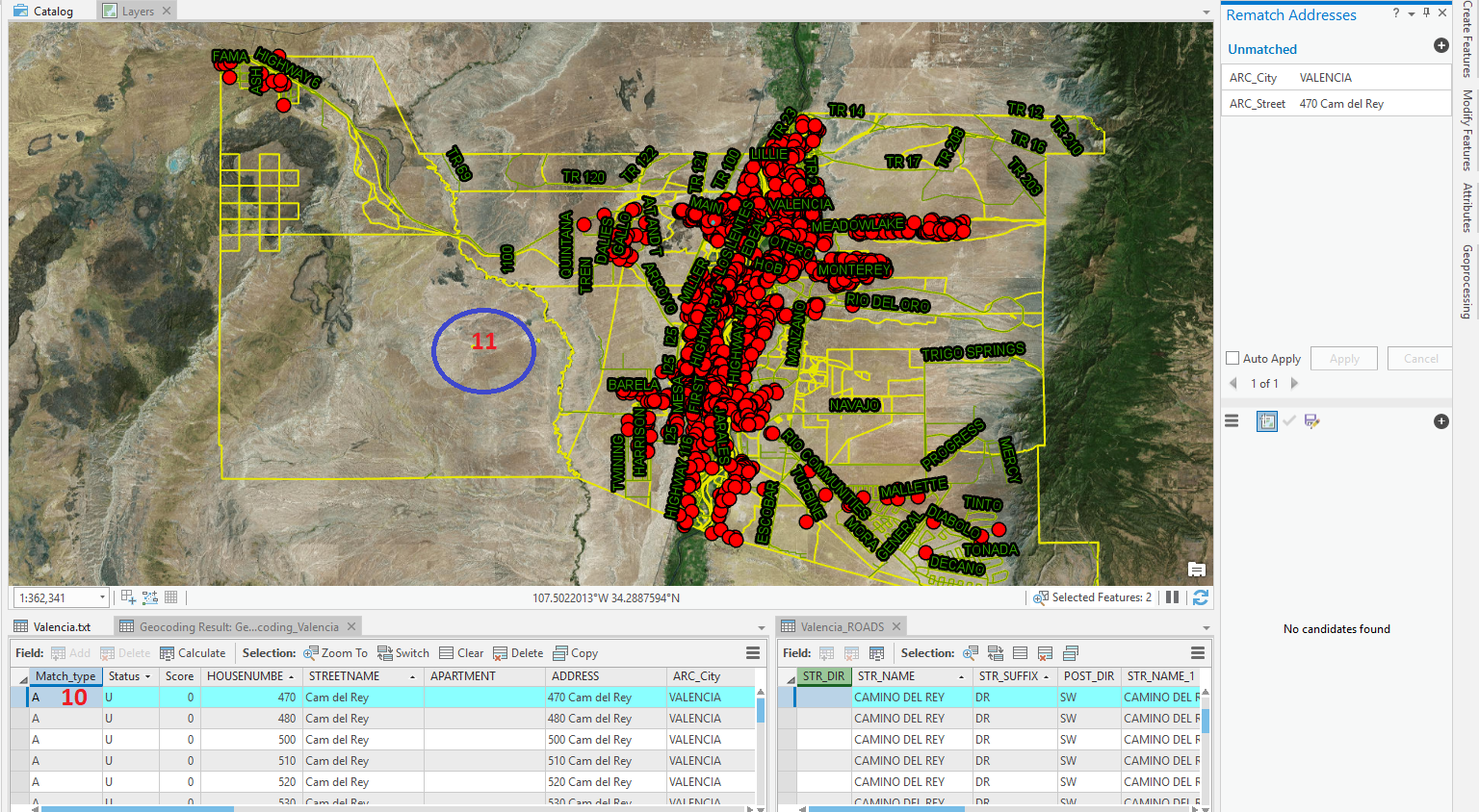

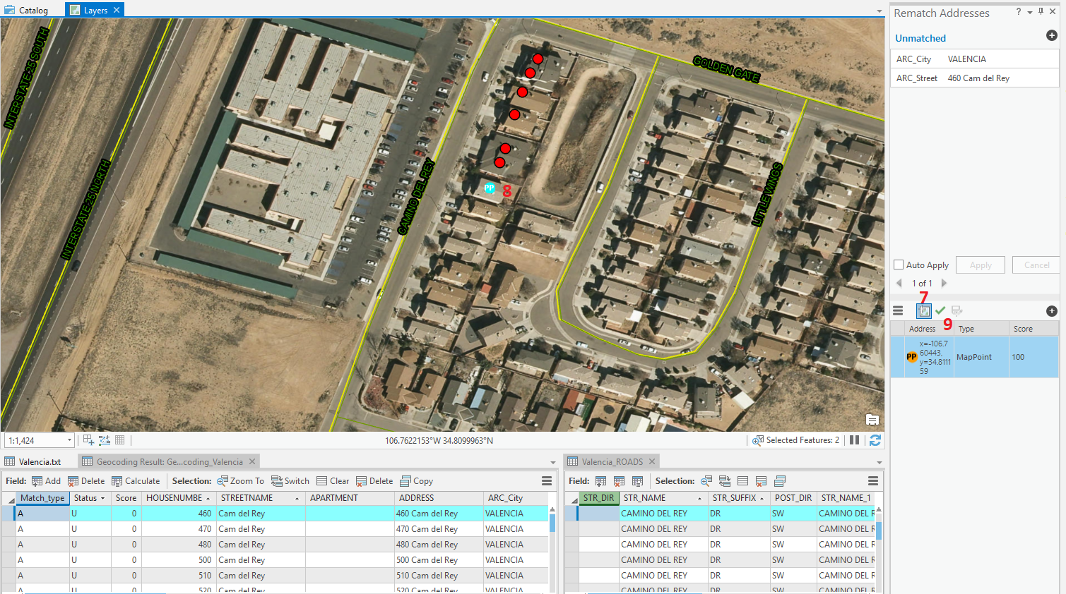

I have a bunch of addresses (label #1) that I need to rematch. Is there an option that the map will not zoom out (label #5 and #11) every time I choose a new row (Label #10)?

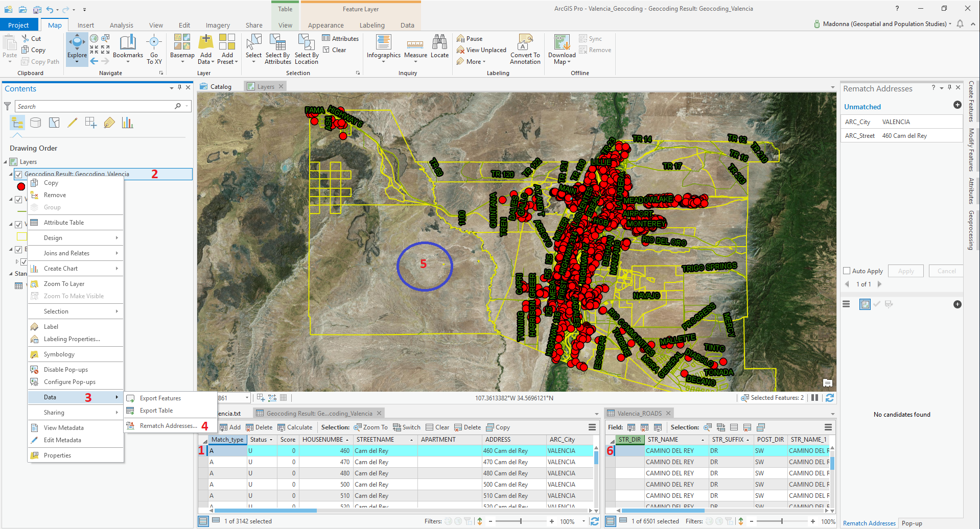

Here's my steps to rematch an address:
Label # 1 = Click the row
Label # 2 = Click the geocoding layer
Label # 3 = Mouse over Data
Label # 4 = Click Rematch
Label # 5 = the map will zoom out
Label # 6 = zoom to the road
Since the next row is just a neighbor, is there an option that once I repeat the steps from Label # 1 with the next row (Label #10), the map (Label #11) will not zoom out?

Is it possible also that the Locate Locate button on the Map tab will be connected with the rematch addresses? I tried to search the location using the Locate button and I found the exact location but once I go to rematch addresses, it will zoom-out again the map. I need to manually find the exact location. It will be better if the map will stay with the result of the  Locate Locate since it is already on the exact house location and I just need to do the steps 7,8,and 9 of my first screen display.
