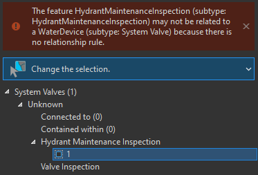

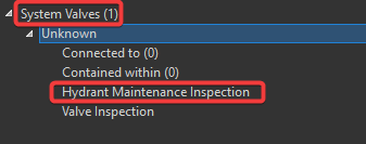

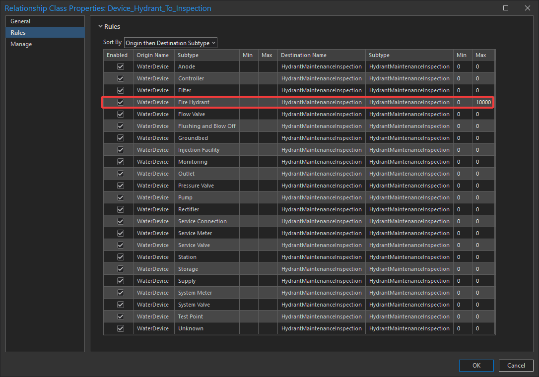

after adding rules to a relationship in order to limit relations with only some subtypes, I can see that it is not reflected in Pro interface.
Here you can see that only Hydrant can have a relation with a hydrant inspection, however when selecting a Valve, the hydrant inspection relationship is still visible. Is this the normal behavior ? I would expect that the relationship is limited to valid subtypes.
Note :  when trying to add a hydrant maintenance in relation with a valve, I get the expected behavior :

Hello, I opened a support case a year ago, and the bug has been reproduced and referenced here:
https://support.esri.com/fr-fr/bug/rules-enabled-on-a-relationship-class-are-not-honored-b-bug-00017...
I also found another bug that seems to describe the same behavior:
https://support.esri.com/fr-fr/bug/relationship-class-rules-that-are-set-to-restrict-relat-bug-00013...
The workaround is to duplicate the layers instead of using subtype group layers, but this doesn't seem relevant for a utility network.
