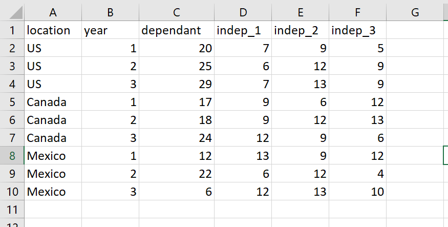

I have a shapefile with 3 countries (US, Canada and Mexico) and an excel file like this:
It has one dependent variable and 3 independent variables for 3 consecutive years. Now I want to run a generalized linear regression analysis (Gaussian). But the problem is that every location on the shapefile only have one value for each variable. For example you can't have 3 Mexicos in one shapefile. Now how should I join the excel and and shapefile to run a regression analysis?
