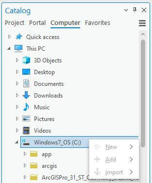

In ArcGIS Pro 3.1, there is new functionality where we can browse folders without creating a connection to a folder. Which is helpful.
Scenario:
In Windows Explorer, I've created a new folder on my C drive. Now, I want to refresh my C drive in Catalog to see the new folder. But when I right-click a drive or folder in Catalog, I don't see a refresh option.
Is there a way to refresh? Or is that functionality missing?
(Similarly, I also want to create a new folder from the Computer tab in Catalog, without using folder connections. But the Right-click >>> New menu option is greyed out.)

Hi - is hiding under the hamburger button.
JohnWatt
Bud
Legendary Contributor
Good catch. Same applies for the Catalog pane:
Side question: Do you see a way to create a new folder or a new geodatabase via the Computer tab?

Hello @Bud ,
