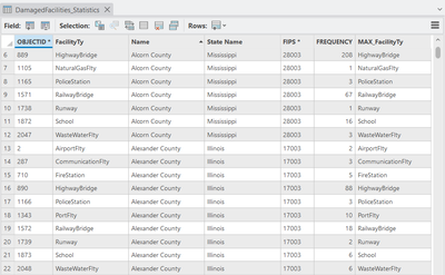

I have an output table from running the Summary Statistics tool. The output looks like this:
I'd like to format it this way:
I have 174 counties, so I'd like to not have to enter the values in manually. 😊 What would be the best way to do this?

like a pivot table ?
Pivot Table (Data Management)—ArcGIS Pro | Documentation
... sort of retired...
dwold
@DanPatterson this is what I needed. Thanks!
