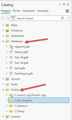

Use Catalog, find a folder containing some data and expand it.  Geodatabase and operating system folders are shown below

Ok I did that

drag one of the geodatabase layers onto the map, its name should appear in the table of contents
If the data doesn't shown on the map, right-click on the layer and select zoom to layer and try opening its table

The data dosnt appear in the list, those are just the ones that show up in the folders

The ones with the red exclamation marks can't be found, so if they aren't in the Catalog view, then you can't associate them with the ones in your project.  You will have to find the data, presumably on the computer that you created it on.  I hope that you have a backup on a local drive and aren't relying on cloud storage or something like that.
So in short... if you can't find the data in Catalog, or you can't connect to another folder or data source in catalog to locate the data, then you can't use it.  Keep searching and connecting to locations in catalog until you find it
