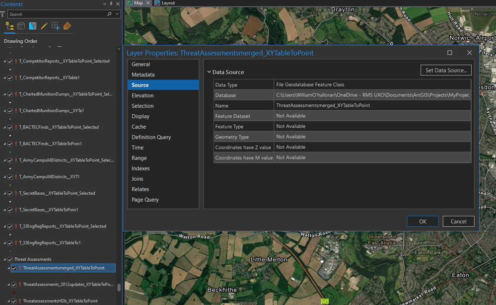

Also, could you take a screenshot of you properties of one of these broken links?
Willoh

Potentially it's because of OneDrive, you may want to consider moving them to a local location on the machine rather than on the cloud to ensure that the connection doesn't break.

If you move the folder with your content from OneDrive onto a local location on your machine, when you repair one of the items, ArcGIS Pro should recognise that the other content is in the same file structure and repair the rest of them as well.
