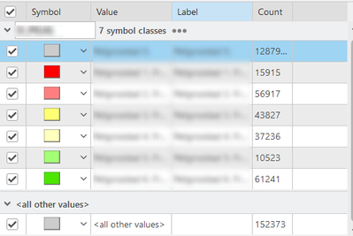

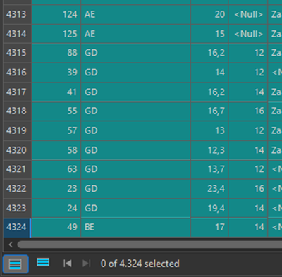

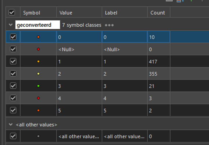

I have a hosted feature layer with 4100+ records, whenever I select records they're not counted correctly:
Also when I create a symbology the count for <Null> values is incorrect:
In the above symbology I have a lot of Null but it counts zero.
Symbologies of other attributes containing Null values also count zero for the Null  value and correct for other values. (like the symbology depicted above)
This makes me feel very uncomfortable. What's wrong here?

While you're building the style it shows the count next to each category.
I don't think it can be added to the actual legend. Someone should lodge an I...
Any unincluded items will show at the bottom and be counted in the 'Other' total.

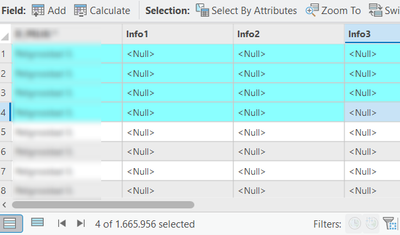

I have the same version than you. I try with a hosted feature layer with 1.666.956 records, and I don't have this problem, count well for me:
I don't know how it's wrong with your data 😞

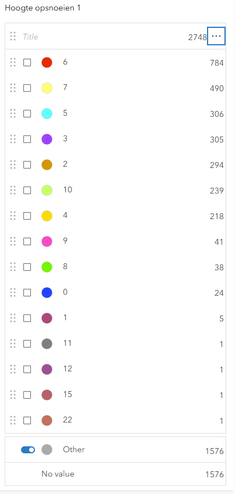

I don't seem to be able to add a count to a symbology in the webviewer, however when I create the same symbology (Unique symbols) several values are omitted in the webviewer which i can see in Pro:
Gisbert61_1-1758699404330.png  I miss 11, 12, 15 and 22.
Regards, Bert
RTPL_AU
Deactivated User
@Gisbert61

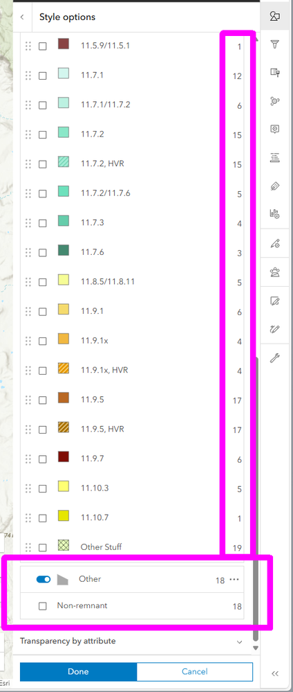

Gisbert61
Aha, I got the count per your example, excellent.
A bit peculiar that symbology simply stops after ten items and does not display the rest automatically but okay I guess.
So I have 1576 <null> values visible as 'other'. This is confirmed by looking at the attribute table
