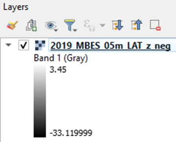

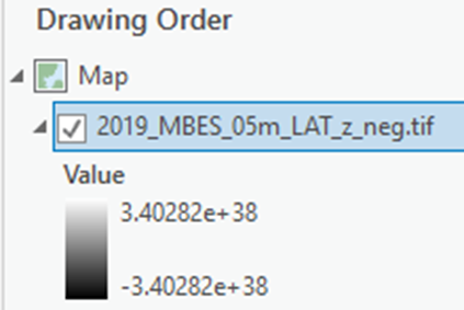

I would like to use a simple raster (1-band) with depth values for the seafloor. Depth range is + 3.5 to - 33.1, so very common numbers. If I drag and drop it into QGIS, in the table of content, the labels for values are shown as 'normal' numbers. If I drag an drop into ArcGIS Pro, the values seem to be shown with scientific notification ("3.40282e+38" for upper and lower value (?!?)). How can this be avoided?
After choosing 'stretched symbology' and 'calculating statistics' the numbers are shown as in QGIS, but only after removing the TIF and loading it a second time. This can't be the normal way, can it?

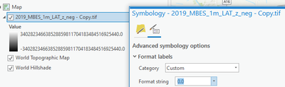

Set focus to the raster in the Contents pane --> click the Raster Layer tab --> click Symbology --> click Advanced symbology options in the Symbology pane --> adjust the Category under Format labels (try Numeric).
ClaudiaFries
Thanks Barry! I already tried this, however using ArcGIS Pro 2.9.3.
Setting the 'Format labels' to numeric (or other options) does not show the desired effect.
In general, the upper and lower values given in the Contents pane seem to be pretty rubbish. As I said, the values actually lie between + 3.5 to - 33.1...
QGIS recognises the min and max values immediately.
ArcMap can't do that, but at least adjusts the values immediately in the table of content after I set the symbology to "Stretch" and run "Calculates Statistics".
And ArcGIS Pro only implements it when I load the file a second time (just drag and drop, after the .aux.xml file has been created) - then, however, it is immediately displayed correctly.
