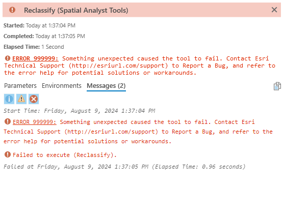

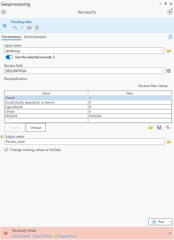

I have a raster that has four land type coverages within the raster, Forest, Scrub, Agriculture and Urban.  I would like to separate this raster into Forest and Nonforest.  What is the best way to do this?  When I try the Reclassify I am getting an error.  I set the new value for Forest to 1 and the remaining into 0.  Any suggestions or pointers would be helpful.  Thanks!Screenshot 2024-08-09 134500.pngScreenshot 2024-08-09 134512.png

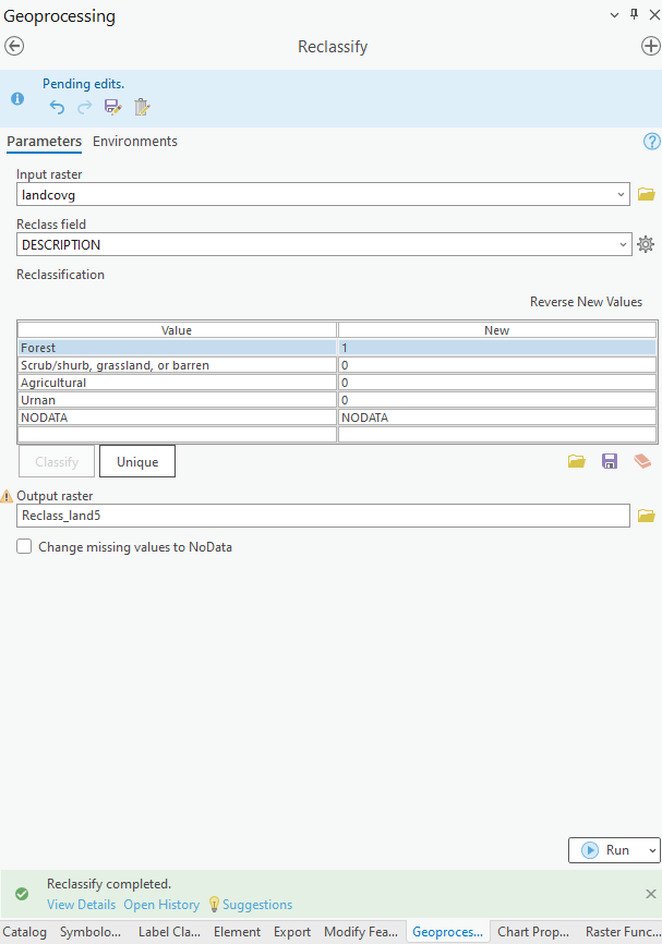

Finally after a couple of attempts (5 or 6) and restarted ArcGIS Pro and then the Reclassify worked. I was able to get the Raster into 2 separate categories. Maybe it's a bug in this version of ArcGIS Pro?!? I am running 3.3.1
