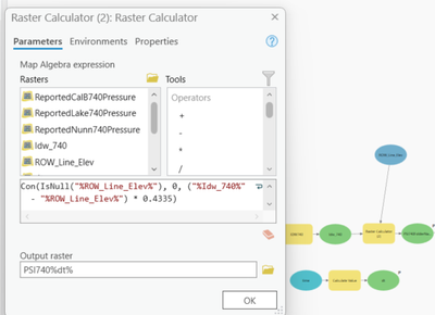

Does anyone know why the raster calculator tool will sometimes not take my inputs? I've been working on a model that will work mostly, and then it will break. The raster calculator seems to be the culprit. It seems to change out my inputs at random to zeros.

what is the raster calculator expression?
Raster Calculator (Spatial Analyst)—ArcGIS Pro | Documentation
there are lots of specifics that need to be met, have you reviewed your expression in light of those?

This works sometimes and other times it won't. I'll open it up there will be zeros instead of layers.
I've also use Con(layer1, (layer2 - layer1) * 0.4335)
