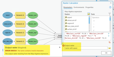

I am trying to perform a weighted suitability analysis with the raster calculator feature, but I am running into a few errors. I attached an image that shows these errors and their error codes.
Here is the script I am using for the analysis:
"%Reclass_Aspe1%" *0.10 + "%Reclass_Slop1%" *0.05 + "%Reclass_Dura1%" *0.40 + "%Reclass_Feat1%" *0.30 + "%Reclass_Feat2%" *0.15

Please try removing the space in the output name:
For example, try replacing the space with an underscore: Final_parcels
I am on a newer version of the software. I get this validation error when outputting an fgdb raster with a space in the name.
Please let me know if this resolves your error and if this doesn't resolve your error please tell me what version on the software you are using.
Thanks,
Liz Graham
Without the space in the output name this works with my data in my version of the software

Hello. It is happening to me if I had started to edit an attribute table, doesn't matter which layer. Save your edits, stop editing and try again.
