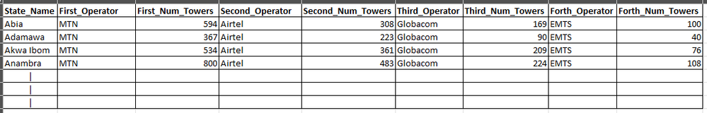

Ranking_Question1.pngRanking_Question2.pngThis is how the final State table should look likeThis is how the final State table should look like

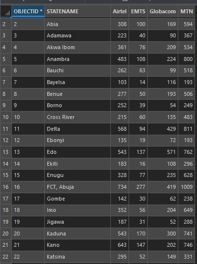

Thanks to @Eugene_Adkins  and @DanPatterson . Your suggestions were quite useful, I performed the spatial Jion as well as the summarize statistics to arrive at the first two images. However, I'll like the final result of the State Attribute table to look like the table in the third picture. I can go through a long path to arrive at the solution. However, there might be an effective way around it. Further assistance will be appreciated.

Thanks so much. Its interesting to note that ArcGIS Pro has a pivot table.
The result after applying the pivot table tool is quite close to what I want, but not exactly.
As shown in the picture, I have the count for each State and the corresponding counts per operator.
I'd like to advance by ranking operators relative to their performance in each state. So I'd like to have columns for First_Operator, Second_Operator, Third_Operator, and Forth_Operator. So for Abia State, under First Operator, it should be MTN since it obviously has the highest number of towers, and the second_operator will be Airtel (the result should be similar to the picture below).Ranking_Question3.png
I hope I have been able to provide sufficient clarity on the problem.

Lucavson
Thank you very much. I opt for the excel as I am not yet good with python.
