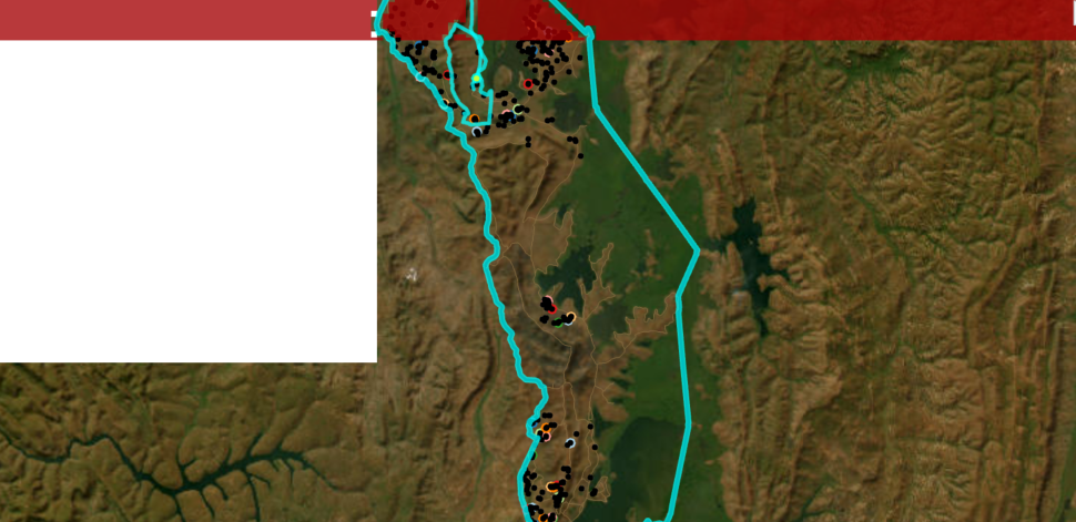

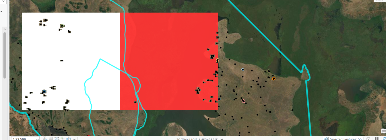

Hi,
Since I've updated to the latest version, I've been getting odd blocks (mainly red and white squares) on my map when selecting data on my map. If I don't have anything selected the blocks dissapear. The position, size, and colour of the blocks change depending on my zoom level (see photos below). Is this an issue with my graphics card or symbology settings?
Thanks!

ArcGIS Pro 3.4 system requirements—ArcGIS Pro | Documentation
check your graphics setting in the project backstage (Project, Options, Display)
 DirectX 12 is now recommended.
While you are on the page from the above link, run the link Scan your computer for compatibility
to verify the current requirements versus your machines offerings.
