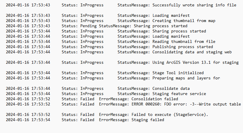

I am looking to upload a feature layer from ArcGIS Pro to ArcGIS Online, as we have done hundreds of times before.
I keep getting this new staging error that I haven't seen before, I even exported my layer as a FGDB directly from ArcGIS Online, imported it to Pro, and immediately turned around to share it without making any edits - it's still giving the error.
I can still upload other layers with no problem, but this one is giving me issues for some reason. Any help would be great, thanks!

Shot in the dark, but are all the fields marked as visible when you’re publishing? I have seen a generic error when all fields are not visible but the layer has a setup that includes things like attribute rules.

Hi - I got this staging error and copied the error details that looks like a bunch of code and pasted it into Chatgpt and it told me there was an issue with one of my domains...I reviewed my layer and found the error. I suggest giving that a try. AI might be able to give you some hints on the issue for you to find it and fix it. I would have never been able to figure out what the problem was without it.
