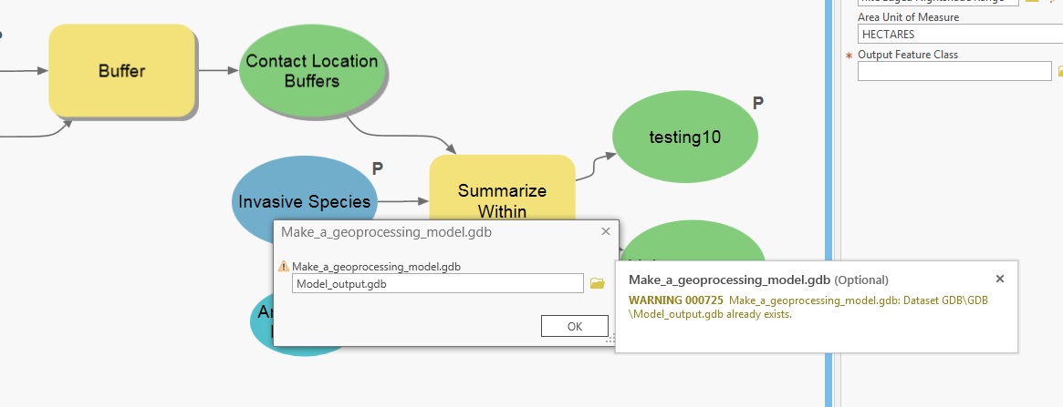

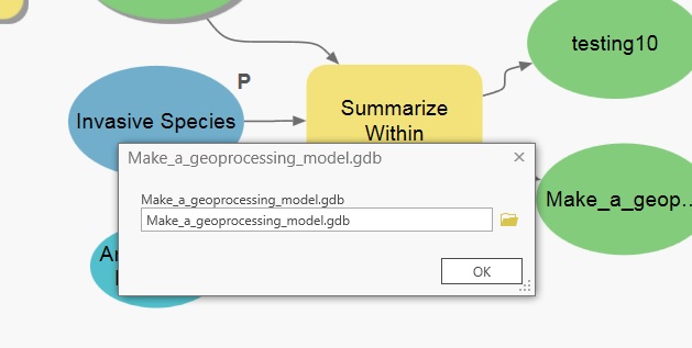

edit: I don't know if this is anything, but I was playing inside the model builder and noticed some possibly odd behaviour. If i try to select a location for the Output Grouped Table output, it will let me select the Make_a_geoprocessing_model.gdb database, but gives an error if i try to select the Model_output.gdb.
edit 2: ignore those pics, I've worked out that error. I was simply selecting the database and it was then trying to create the output file with the same name. If i double click the database and then enter the name i want then it saves to the correct location. However, that still doesn't fix my issue with the scratch workspace, but at least i can get outputs where they are supposed to go, even if it's a couple of extra steps.

Confirming your edit 2 on the output grouped table name... you have to specify a file name for the table, not the geodatabase name.
