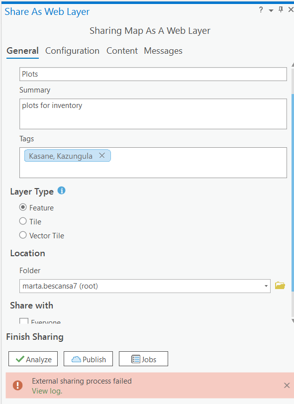

Dear community,
I am having problems to publish a feature layer to any of my ArcGIS Online accounts. I assume it is an internal system issue. Could someone please assist? I have an urge to finish a project and I won't be able to do it until I am able to upload my files. I am using ArcGIS Pro 2.5.2
Many thanks,
Marta
by Anonymous User
Not applicable
This error can have a few causes. Have you tried a new Pro project?
What type of feature is this, feature class? Shapefile?
Anything else you have tried?
I've seen numerous underlying issues as outlined in this article: Error: External sharing process failed
If all else fails, it would be best to connect with technical support if you are able to submit a case?
lzorloni
Hi Marta,
I had the same problem with my ArcGIS Online. I found a "solution" changing the data format in my profile in AGOL. I don't know if this can solve your problem. I wrote my solution here:
ArcGIS Pro publishing error "External sharing proc... - Esri Community
Lorenzo
