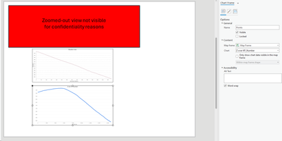

I am trying to generate a catalogue using map series along a pipeline. By making use of the strip map index tool, I can set up a layout page with views "along" the feature line that I want to describe. However I wish to add the local elevation profile, and with the use of a 3D line feature class, I managed to add a Profile Graph as a chart.

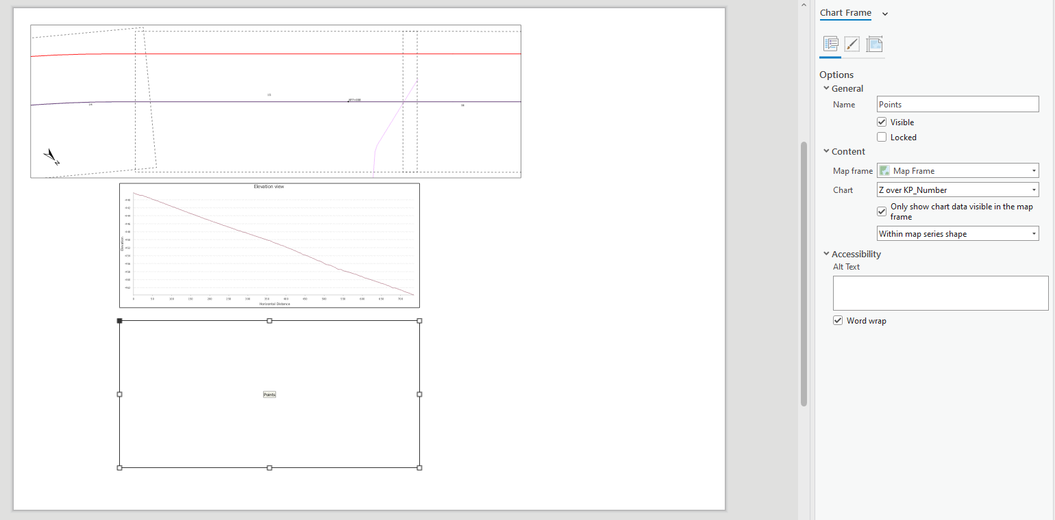

Adding this in my layout page, I can tick the option to only show what is within the extent of the map series shape. However, there are 2 big issues with this process :
1) The horizontal distance axis is set to 0 at the beginning of each page and I can't figure out how to leave the "absolute" KP distance.
2) On top of this, I can't seem to add data on this profile graph (e.g. if there are punctual features that I want to highlight such as crossing, structures, geohazards etc.)

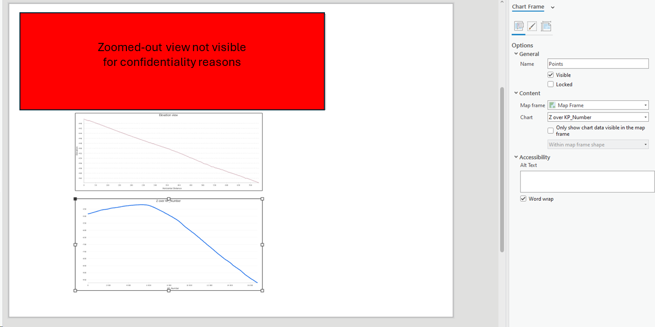

I tried to change the graph type and use a line chart instead. I created a point feature class along the previous line and adding the Z information in a dedicated field, but this graph doesn't show data when I tick the "only show chart data visible in the map frame" : the window stays blank with a "Points" label in it. It only works if i untick the option to show local data AND if the map frame is zoomed out to show the whole line, which defeats the purpose of the map series.
