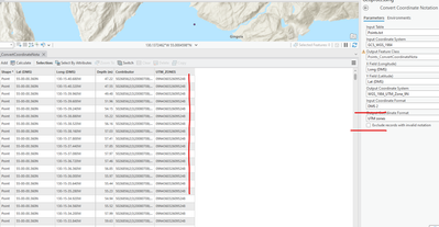

Please don't retired. 😉 thanks for the tips. I can put the data in, but seems something is off. the output points are in one spot. any ideas?

Could be something is wrong with the data or there are multiple points at one location.  I would toggle on the last checkbox to exclude locations with improper notation

I think it is the format GIS doesn't like, seems like it only recognize the first couple digits, so end up tons of points in one spot. If i toggle that checkbox, nothing got imported.
