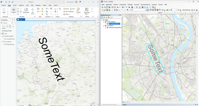

This is easily reproducable:
I created an annotation feature class in ArcMap and replaced the value in the "TextString" field with the text-formatting tag I posted earlier:
<FNT name = 'Arial' size = '9,41'><CLR cyan=  '0' magenta=   '0' yellow=  '0' black= '153'><ITA>SomeText</ITA></CLR></FNT>
Saving and importing that map in ArcGIS Pro results in the following.
On the right hand the text in ArcMap and on the left hand the text in ArcGIS pro, displayed with a font size of 941 instead of 9.41.
I was very surprised that I couldn't find anything about this in the forums. There must be a fix for this that doesn't involve creating a new annotation feature class?!
