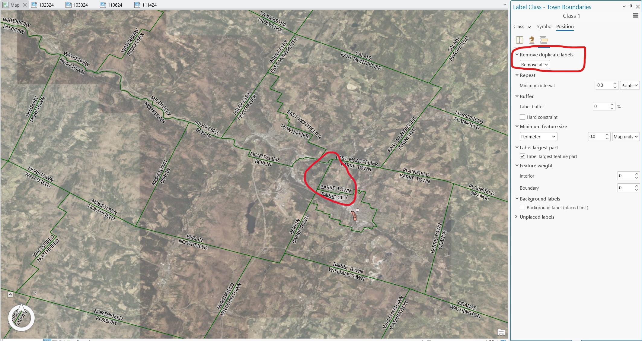

I see this post is from 2018, but I am still experiencing this problem with ArcGIS Pro 3.4.0. I am using Boundary Placement for a polygon layer for towns. I have Remove duplicate labels set to Remove All, but it only removes one set of labels. Using Remove within fixed distance doesn't do anything different either. Can someone explain why this is happening? I would rather not have to convert labels to annotation.
Oddly, the opposite problem is happening for labels with River Placement. Even though there are multiple lines with the same label, and Remove duplicate labels is set to Do not remove, only one label per stream shows up.
