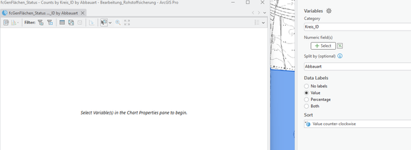

@ChristopherAllen  Just got 3.6.2 and it is still a problem. Now the charts are empty as soon as I set a Split by field. ☹️

Hi @FranziskaSumpf , I'm sorry to hear you're still having issues. The original reproduction case (where series values were duplicated across all series) appears to be fixed using our test data in 3.6.2. You said that you are now seeing the chart display as empty when you set a Split by, so answers to these questions would be very helpful:
* Are you ever seeing the original issue (duplicate values) at all now? Or is the chart always displaying as empty when you set the Split by field, so you never actually see any values?
* Are you using the same dataset and fields you were using in your original post?
* In your screenshot, it appears that the empty chart is a pie chart. Have you tried a bar chart?

Hi @ChristopherAllen , I've looked into it some more and can now say, that the problem only occurs in some cases. It just happened to affect all charts/layers that I tested on Tuesday.
But first, to answer your questions:
  • No, as far as I can tell, the duplicate charts have not shown up again.
  • Yes, same datasets, same layers, same project. The original error occurred with all my data, across all projects. Also if I recreate the affected charts with the original data in a different project the error occurs.
  • Bar charts and pie charts are both affected (have not checked other types)
But here's the catch:
I checked the chart from the original screenshot (with the four identical charts), and that one is okay now. As are other charts in that project with those data. However, the data that I work with daily shows the new error. I've tried to figure out where the differences are. So far I can tell, that it only seems to occur if there is more than one join involved, i.e. the feature class is joined to two separate tables (the order in which the tables where joined made no difference). If I delete all but one join I can create a chart with a split, as soon as I join a second table the chart breaks.
I have tried to recreate the error with some very simple feature classes and tables, but so far without success. I'll continue looking into it next week.
