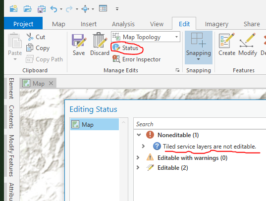

JustMapSynch
I was trying to merge some administrative regions and was also getting this error message:  "The destination layer type cannot be merged."  Clicking on "status" (see screenshot below) let me know that the problem was that I was using a "tiled service layer" (basically an image, not a regular feature layer) that couldn't be edited.  I was able to copy the tiled layer to a feature layer, open the feature layer, and do my merge there.
