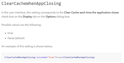

RobertAkroyd1
Thanks @KoryKramer .  We can set the ClearCacheWhenAppClosing, but that will only mitigate slightly, as the vast majority so far is consumed by the StagingPath.
