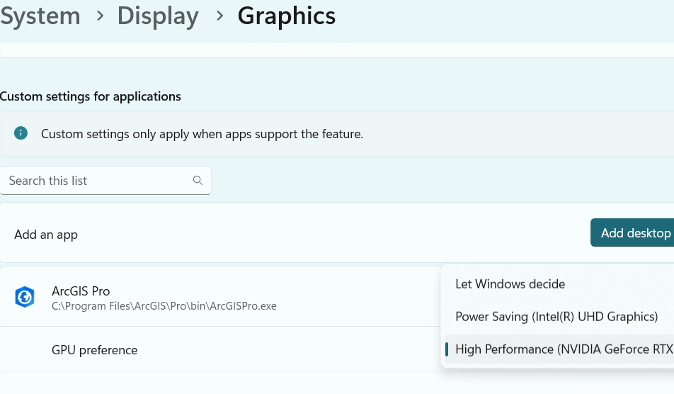

In the Windows System > Display > Graphics settings (custom settings for applications) you can specify which graphics card a particular application uses, either iGPU or dGPU. You can force iGPU or dGPU or let Windows decide (will usually select iGPU).  I always ensure Pro is set to use my NVIDIA dGPU as it's a bit slower when using the iGPU.

Thanks for the response, but I am well aware of how to specify which gpu an application should use. Pro is set to use my 4060 in both Nvidia control panel and my windows settings.
