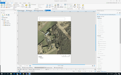

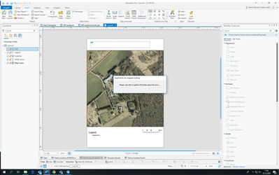

Does anyone have the same problem? Pro crashes immediately when I am editing text in my layout view. Furthermore, every time when I have tried to send an error report, it fails to send it. It happens very quickly: I choose to draw the text box and immediately when I am done drawing it, Pro crashes. I also tried to add Scale from the dynamic text options, which worked. However, when I tried to edit the text in Scale (I need to translate the word 'scale') Pro crashes.
Two pictures to illustrate the crash in layout view:
1. Adding text box
Trying to add text to my layoutTrying to add text to my layout
 2. Pro crashes the second I release my mouse to finish drawing the text box
Crash literally the second I finished drawing the boxCrash literally the second I finished drawing the box

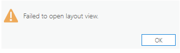

Issue 2: Failure to open Layout View
The following message appears when opening a layout view.
We are trying to get a reproducible case to investigate this further. It may be related to Spell Check and for those running into this issue it may be worth it to disable Spell Checking.  As we have been unable to reproduce the issue we cannot confirm the work-around.

I have the exact same issue with text boxes. I can't draw a rectangle text box to my layout, AP immediately crashes. I also have trouble with open layouts made in AP 2.6 that have text boxes. Then I get error message "Failed to open layout view"

Most of my layouts from 2.6 still open, but I also had a similar issue with some of them. I tried to change the text on a layout I had created in 2.6, pro crashed and when reopening it, I got the same error message of "Failed to open layout view". However, this did not happen to all of them.

After I updating the software to ArcGIS Pro 2.7, it always shows "Failed to open layout view" when I open my previous layout. Even if I make a new layout, when the software is restarted, it shows  "Failed to open layout view" again. I have tried to disable Spell Checking, but it doesn't work.

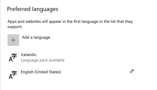

SteinþórTraustason
Hi Huanglei
One solution that I got from support team is to add English  to the Preferred languages in Windows Language settings . They told me it solved this problem for few people, but I'm still out in the cold. I had to downgrade to 2.6 just to be able to work on AG pro.language.jpg
