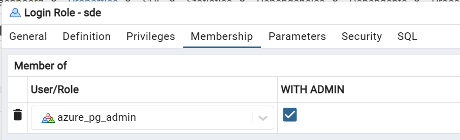

2) SDE login role is also a member of azure_pg_admin.

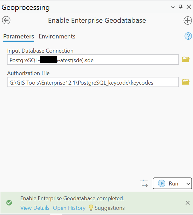

Pro 3.6.3 works fine:
I then signed-out of that Pro 3.7.1 AVD machine and signed-into a Pro 3.6.3 machine.
Ran the exact same Enable Enterprise Geodatabase tool, with the same database connection file (SDE user), also the same 12.1 keycodes authorization file.
Success.
