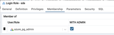

1) PgAdmin4 is running on the AVD machine, we connect to the db instance as admin user, then create a new database, owned by SDE.
2) SDE login role is also a member of azure_pg_admin.
3) Pro 3.7.1, create new db connection to the new db, connecting as user SDE, save credentials in connection.

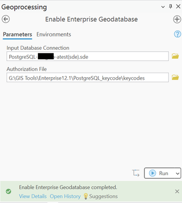

Pro 3.6.3 works fine:
I then signed-out of that Pro 3.7.1 AVD machine and signed-into a Pro 3.6.3 machine.
Ran the exact same Enable Enterprise Geodatabase tool, with the same database connection file (SDE user), also the same 12.1 keycodes authorization file.
Success.
