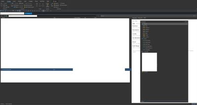

I get there, but the only thing I can find an editing option for is the metadata:

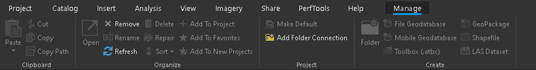

It's not in the Manage tab:
The menu you get from right clicking on the style has nothing:
What am I missing?

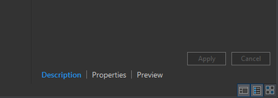

Right click your existing style and click manage style. Under the Styles section in the Contents pane you should see the symbology associated with your existing style. Double click on the symbology and look at the bottom right and you should see Description | Properties | Preview
That's as far as I've gotten so far.
Hope that helps

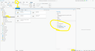

The trick really is to open up catalog from the View Ribbon and ensuring that the detail pane is open. This is where you will find the Style Classes to work on.
