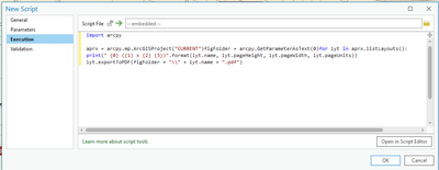

I had to search for the script again. Since this discussion is the first result from searching the web, I thought I'd include the custom script used to print these out. It's real simple, which is why this functionality aught to be included in the full version of the software.
https://gis.stackexchange.com/questions/271468/batch-exporting-layouts-to-pdf-in-arcgis-pro-using-ar...
import arcpy  aprx = arcpy.mp.ArcGISProject("CURRENT")figFolder = arcpy.GetParameterAsText(0)for lyt in aprx.listLayouts():    print(" {0} ({1} x {2} {3})".format(lyt.name, lyt.pageHeight, lyt.pageWidth, lyt.pageUnits))    lyt.exportToPDF(figFolder + "\\" + lyt.name + ".pdf")
To create a script tool: https://pro.arcgis.com/en/pro-app/help/analysis/geoprocessing/basics/create-a-python-script-tool.htm

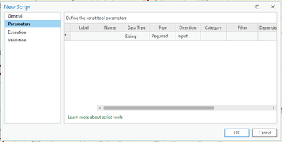

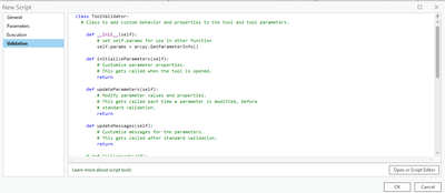

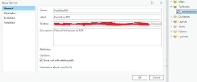

Please may I ask for some help with creating this script? What do I add in the "Parameters" tab? Do I need to format the script from above in any particular way? I am a complete newbie to this... thanks!
"General"
"Parameters"
"Execution"
"Validation"
