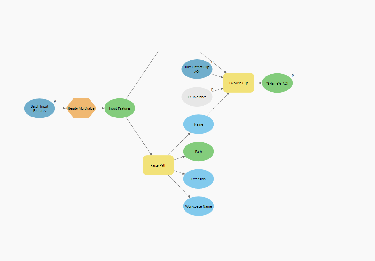

Hi everyone
I am pretty new to ModelBuilder. I create a Model by using the batch Pairwise Clip tool, then viewing my Geoprocessing history and sending that to a model.
The model accepts 8 feature classes, clips by an area of interest, and then renames the new features via %Name%_AOI.

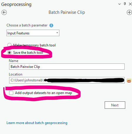

When I ran the batch Geoprocessing task the first time I unticked 'Add output datasets to an open map'.

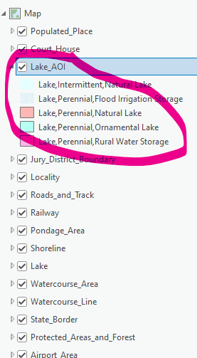

However, when I run the Model subsequently, every time, 1 of the newly created clipped feature classes always gets added to the map.
I cannot understand why, and where in the Model process I can see this happening to stop it from happening when people use the model in the future.

Model:
How to prevent this 1 feature class from being added automatically after model runs? (Can vary which one is added each time):
When I create the Model from first running the Batch Pairwise Clip, I make sure this is off:
Tool runs fine and makes the clipped feature classes correctly, but why is 1 at random added to the map?:
