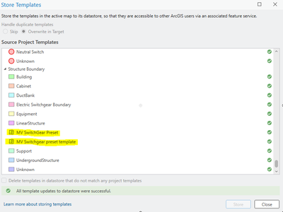

I managed to store a template for use in the web editor but I get this error when I try to use it.

2. Create a preset template.

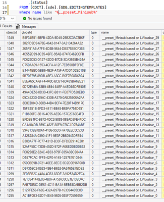

3. Store all editing templates. The preset template shows in the database:

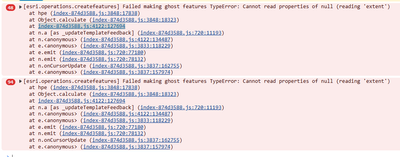

9. Click on the map to create the features. I no longer get the error I used to get, but no features are created. At this point I see in the Console of the Developer Tools the following:
The Network tab in Developer Tools has no errors

@CraigGillgrass I managed to create a group template and get it to display in the web editor. I could create the features successfully.
I again got the error I previously mentioned 'Editing failed' when I tried to use a preset template and the Console window of the Developer tools displayed this:
