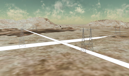

  • Which results in this in city engine:
The rule in a tilted direction
Just the asset, a collada file .dae

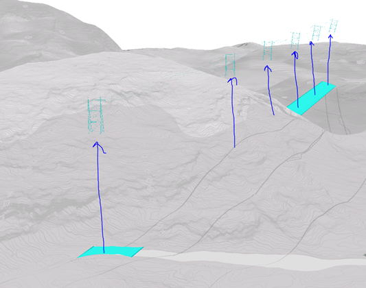

  • Here is what happens when I create a polygon in an area with some relief (the elevation of the feature class is set to “on the ground”):
The Powerline is floating in the air

I'm not sure why the power line is floating in the air.  I don't think it's the code because it seems to work in CityEngine.  However, the code does have some scope changes that could be avoided.  Here is a shorter version that you could try out to see if the power line still floats.

As for Pro, aligning a single 4-vertex polygon to the terrain is not possible (except when you drape it onto the terrain, but this doesn't actually change the polygon, so the rule won't work as desired in this case).  You would have to add more vertices to the polygon and align those to the terrain.  But, if you apply your cga rule to the non-flat polygon, then it probably won't work as intended.
So, if you can break up the polygon into several smaller polygons and align each of those to the terrain, this would get you closer to aligning your geometry to the terrain.
We are working on similar problems, and I know this is a tricky issue.  We are glad to have your feedback as it gives us a valid use case, so thank you for sharing it.

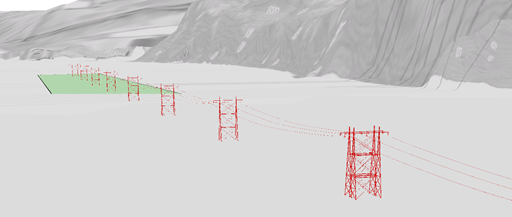

I managed to get the poles to follow the terrain by actually using interpolate shape tool.
But ass you predicted this wont work as intended.
I have isolated it down to perhaps have something to do with the drawingorder of the start- and endpoint of the underlying polygon.
Ass you see here the orientation of the vertices on the polygon is not following the same drawingorder. It seems to me that they are following "a north-south rule" (the northrn vertex is always the start- and endpoint)
This is important, because the rule is telling that the non-start-/endside of a polygon should start with a power pole and the other side should end with a power cable.
Do you got any ideas how I could have a concise drawingorder of the vertices (same for all the polygon pieces)?
