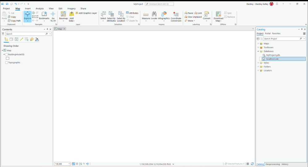

I am trying to connect a PostgreSQL/PostGIS database to ArcGIS Pro 3.0.  When I make the connection, no error messages appear, so I believe the connection was successful.  However, when I double click the database connection, no files are present.  I have several tables present in the database.  I have provided screenshots.  What should I do?

Ah, ok. To determine the version in PGAdmin, open a query window and run either of the queries below:
show server_version; or show server_version_num;
ArcGIS Pro does not support PostgreSQL 14.x at this time: https://enterprise.arcgis.com/en/system-requirements/latest/windows/database-requirements-postgresql...
So I wonder if that is the issue.

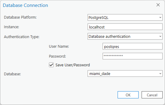

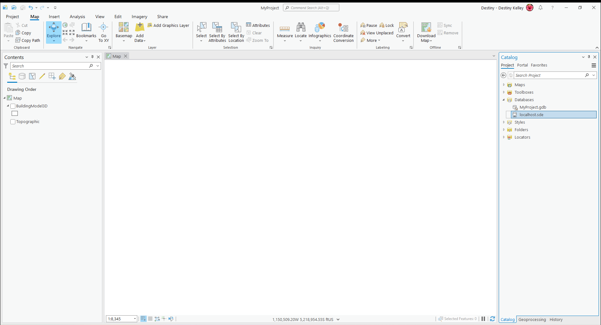

The version I have on my machine is PostgreSQL 14.5.  I do not know if the postgres is a geodatabase, but I have provided a screenshot below.  How do I determine this?  Thank you

DestinyKelley1
I run the query and the current server version is 14.5.
Can I simultaneously install PostgreSQL 13.6 (64 bit) / PostGIS 3.2 without uninstalling the current versions, and then import the database to the earlier versions? Or do I have to re-add the tables?
