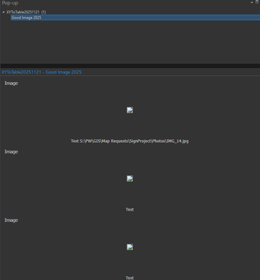

Popups - cannot see image
480
11-24-2025 12:21 PM
GeorgeJonesRIGOV
Hi all, I cannot see popups inside of ArcGIS Pro as seen in the image. Any advice on how to fix it? thanks ..i might be on the right track. NewImageryToday.png
tomESRI
Is the filepath accessible to you?
24126: Elements with a locally referenced file path may not display correctly in the pop-up
"Do one of the following:
  • Open the Configure Pop-ups pane for the layer and update the source URL definitions for image elements and text element hyperlinks in the layer.
  • Remove the image or text element if it is not needed.
  • Do nothing. The image or hyperlink may not display properly."
