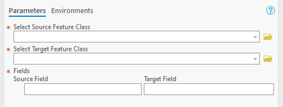

Populate two columns of a value table parameter with field names derived from two other parameters
2918
09-25-2023 02:33 AM
MattHowe
I'd like to populate two columns of a table of values string parameter in a custom Python tool (non Python toolbox) with fields names from two other parameters. In the example, the first column would have a list of fields from parameter 0, and the second column a list of fields from parameter 1. I only have the option of choosing one dependency in the parameter list (of which works great) but I also need the other parameter. How should Value Table parameters be handled in the validation script so each column's filter list can be defined?

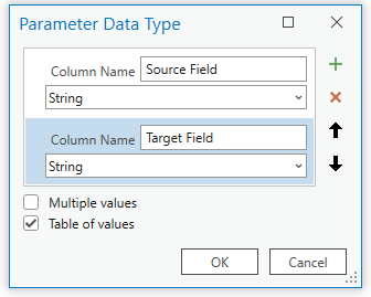

MattHowe
Figured it out. I'd set the individual column data types to field when they should have been strings then set the filter. Validation code below does the job.
