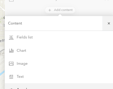

Either way, you can pipe that text into an image URL this way. Add an Image item to your popup:

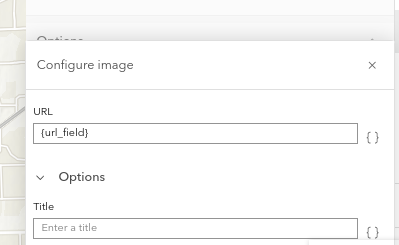

Then use your field (or some/url/{attribute}.png or similar):
That's it!
