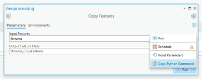

This can all be done with arcpy. I suggest doing the process manually with the Pro tools and copying the Python command. I find this speeds up dev time quite a bit!
The Pro tools would be Copy Features (input hosted feature layer, output feature class), whatever you were doing locally before to the feature class, Truncate (input is hosted feature layer), and Append (input layer is updated feature class, target layer is hosted feature layer)

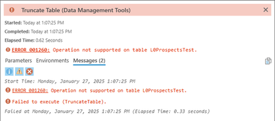

Hi @EzraBosworth-Ahmet , I'm attempting the truncate/append method. However, the truncate tool fails on the hosted feature layer. Since my original post, I upgraded Pro to version 3.3 which I thought supported truncating hosted layers. But it still fails. I'm also seeing things about the 'supportsTruncate' setting but don't know how to update that. The sync option is not enabled on the layer. Any thoughts?
