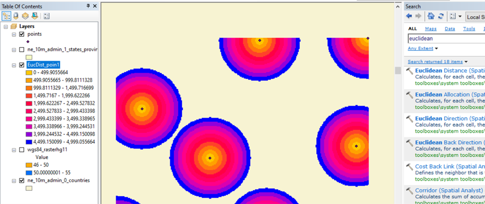

DavidPike
MVP Notable Contributor
the max distance is the max from each point, i'm not sure what you mean.
the euclidean distance is a raster where each value is the distance to the closest input feature.  i quickly ran the tool to demonstrate.  this can easily be converted(reclassified) to your desired bands.
