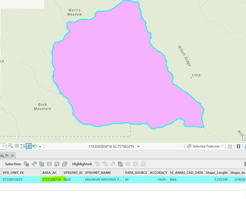

There are discrepancies when calculating area of a polygon between Calculate Geometry on the attribute table and the code I tried in Pro SDK. I need to produce the same result what Calculate Geometry on the attribute table or Measurement tool.

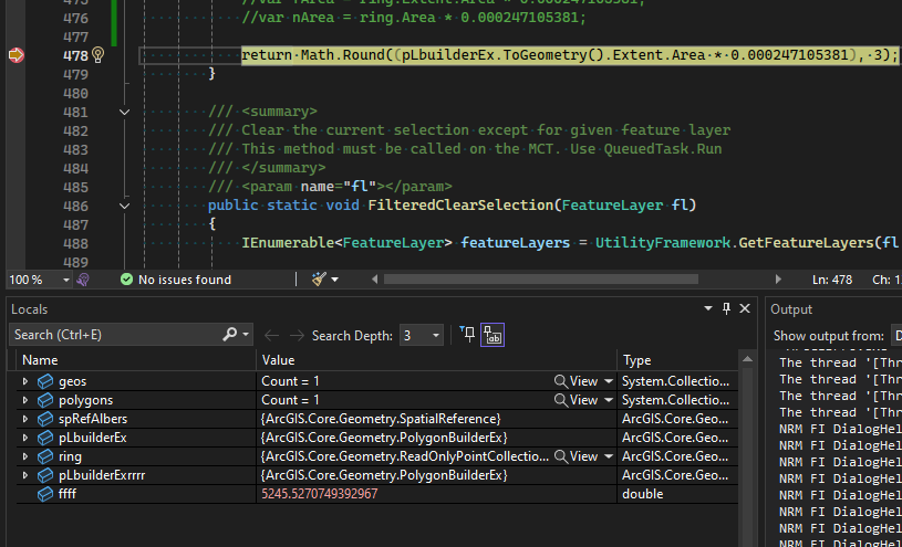

Here is my code:
public static double CalculateArea(List<Geometry> geos)
    List<Polygon> polygons = [];
    var spRefAlbers = SpatialReferenceBuilder.CreateSpatialReference(AlbersUS1983WkId);
    foreach (var geo in geos)
        if (GeometryEngine.Instance.Project(geo, spRefAlbers) is Polygon plg)
            polygons.Add(plg);
    PolygonBuilderEx pLbuilderEx = new(polygons, AttributeFlags.None)
        HasZ = false,
        SpatialReference = spRefAlbers
    //Unit for AlbersUS1983 is meter
    return Math.Round((pLbuilderEx.ToGeometry().Area * 0.000247105381), 3);
I also tried pLbuilderEx.ToGeometry().Extent.Area, getting polygon exterior ring, geodesic area calculation etc. but no luck
There is about 500 acres difference any idea why?
