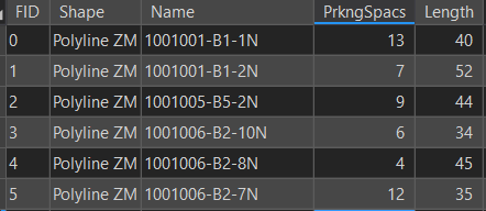

I have to generate points along a line based on a field [PrkngSpacs] value. I need to do this for around 10k lines in a multipart polyline feature. I checked few tools available that generates points based on distance and intervals. They are working fine with single line, but i do not know how to make them loop through each of my attribute values in [PrkngSpacs] field and create same number of points.  Any help in how to accomplish this is much appreciated.
